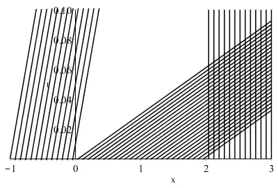

(a) Here is a plot of the characteristic lines in the $x$-$t$ plane.
characteristics
Since the flux $u \mapsto u^4$ is convex, the classical theory for entropy solutions of conservation laws applies. Without entering into details, the rarefaction wave generated at $x=0$ and the shock wave generated at $x=2$ leads to the solution $$ u(x,t) = \left\lbrace \begin{aligned} & 1 && x \leq 4 t \\ & \sqrt[3]{x/(4t)} && 4 t \leq x \leq 32 t\\ & 2 && 32 t \leq x \leq 2 + 8 t \\ & 0 && x \geq 2 + 8 t \end{aligned} \right. $$ valid for small times $t < 1/12$. For larger times, one must compute the interaction of the rarefaction with the shock (see related posts on this site, e.g. this one). Here, a shock wave is obtained, whose position is governed by the Rankine-Hugoniot condition $$ \frac{\text d x_s}{\text d t} = \frac{[u^4]}{[u]} = \frac{(\frac14 x/t)^{4/3} - 0^4}{(\frac14 x/t)^{1/3} - 0} $$ with initial position $x_s(1/12) = 8/3$, leading to the shock trajectory $x_s(t) = 8 \sqrt[4]{4t/27}$. At $t=1$, we have $x_s(1)\approx 4.9632$ and $$ u(x,t) = \left\lbrace \begin{aligned} & 1, && x \leq 4 , \\ & \sqrt[3]{x/4}, && 4 \leq x < x_s(1) , \\ & 0, && x > x_s(1) . \end{aligned} \right. $$
