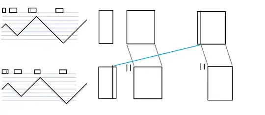

The below image illustrates what happens when you increase the value of one number in the sequence by $\Delta x$:
  • you have a small sliver with width $\Delta x$ with a probability mass of $pdf(s[n]) * \Delta x$, where $pdf(s[n])$ is the value of the PDF at that location. Importantly, since the normal distribution is symmetrical, the fact that our sequence is unsigned doesn't affect $pdf(s[n])$. This block moves earlier in time by a distance equal to the length of the first gap, the next block, and the second gap. This is the same as 2*(second gap), which is the same as $2*(s[n+1]+s[n])$. The overall benefit is thus $$pdf(s[n])*\Delta x*2*(s[n+1]+s[n])$$
  • All the remaining blocks (which includes all remaining probability mass not already covered by the search) is pushed back in time by an amount equal to $2*\Delta x$. The overall penalty is thus $$2*\Delta x*rem$$ where $rem$ is the remaining probability mass
