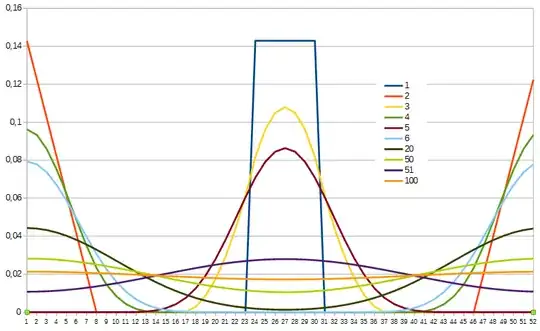

For the first iterations you get a convolution of discrete uniform distribution (of $7$ values each), which will tend (for, say $n\approx 12$) to a Gaussian distribution with variance $4 n$ ($\sigma =2 \sqrt{n}$), alternatively centered around cards $27$ and $1$. Afterwards, there is a cyclic overlapping, so I don't think an analytic expression will be very simple (cf wrapped normal distribution).
You can solve this numerically by modelling it as a Markov chain with 52 states (positions).
Then, if $P$ is the transition matrix, the desired probabilities (after $n$ cuts) can be found in the first column of $P^n$.

One possibility is to put algebraic structure on the cards. They may be the elements $0,1,2,3,\dots, 51$ of the abelian group $\Bbb Z/52$ of the integers taken modulo $52$. Then let us start we $S_0=0$.
Completing a cut means adding to $S_0$ a random variable $X_1$ which is taking the values $26+k\in\Bbb Z/52$ for $k\in\{0,\pm1,\pm2,\pm3\}$ with equal probability $1/7$, and any other number with probability zero.
We can perform further cuts.
Then we add further random variables $X_2,X_3,\dots$ which have the same "shape" (repartition) as $X_1$. It is natural to write $X_k=26+Z_k$, so $Z_k$ takes values in $\{0,\pm1,\pm2,\pm3\}$ with probability one.
We have $S_0=0$, then
  • $S_1=S_0+X_1=26+Z_1$ is "near" the middle $26$,
  • $S_2=S_1+X_2=Z_1+Z_2$ is "near" the start $0$,
  • $S_3=S_2+X_3=26+Z_1+Z_2+Z_3$ is "near" the middle $26$,
  • $S_4=S_3+X_4=Z_1+Z_2+Z_3+Z_4$ is "near" the start $0$,
and so on. I would start the repartition of the process $(S_n)$ using this language...
