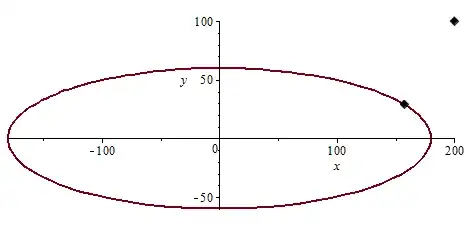

The formula in the linked answer is correct; however, the issue is that the equation for $t$ may have up to four solutions (it's a polynomial equation of 4th degree). In the specific example here, -8768.46 is the right value of $t$ to use. It gives the point with approximate coordinates (157,29), which is the correct answer:
nearest point

To make the life of numerical routines easier, you should clear the denominators prior to solving. It makes the equation slightly longer for humans to read, but easier for numerical methods to handle. $$ a^2u^2(b^2-t)^2 +b^2v^2(a^2-t)^2 =(a^2-t)^2 (b^2-t)^2 \tag1$$ Here is how I coded this in Maple:
a:=180; b:=60; u:=200; v:=100;
t0:=min(fsolve((a^2*u^2)*(b^2-t)^2+(b^2*v^2)*(a^2-t)^2=(a^2-t)^2*(b^2-t)^2));
x0:=(a^2*u)/(a^2-t0); y0:= (b^2*v)/(b^2-t0);
Here fsolve is used instead of solve, because solve may also find complex roots of the polynomial, making min throw an error: complex numbers are not ordered. When used for polynomials, fsolve finds all real roots. If I did not use clear denominators, it would find one real root only, not necessarily the one I want.
Finally, the graphic output part which made the plot shown above.
with(plots):
ellipse:= implicitplot(x^2/a^2+y^2/b^2=1, x=-a..a, y=-b..b, thickness=2):
points:= pointplot([[x0,y0],[u,v]], symbol=soliddiamond, symbolsize=20):
display(ellipse, points);
