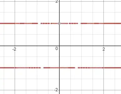

We know that $(-1)^{\frac 12}$, $(-1)^{\frac 14}$, ... $(-1)^{\frac 1{even}}$ all result in complex answers, whereas $(-1)^{\frac 13}$, $(-1)^{\frac 15}$, ... $(-1)^{\frac 1{odd}}$ all result in real answers. I believe this comes from the definitions that $(-1)^{\frac 12} = \sqrt{-1} = i$ and $(-1)^{\frac 13}=\sqrt[3]{-1}=-1$. Moreover, of the set that provides real answers, if the numerator of the exponent is even, the result then becomes $+1$ instead of $-1$. This explains why the graph $y = (-1)^x$ results in an infinite amount of discontinuous points on $y=1$ and $y=-1$, only existing where the denominator of the exponent is odd:
graph of negative one to the x
