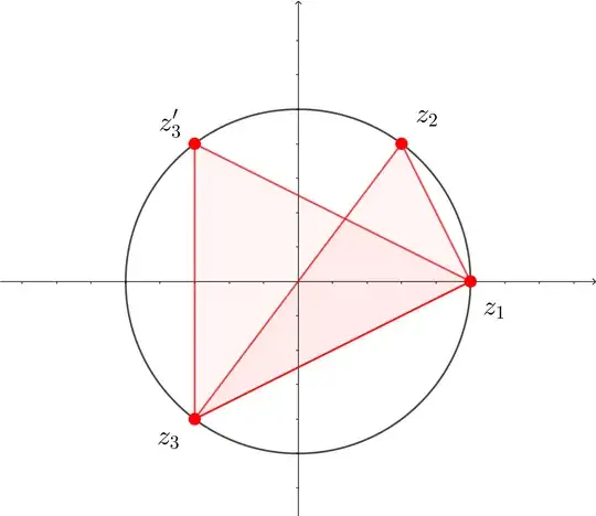

  • I modified the answer, taking into account a comment pointing out to me that once $z_1$ and $z_2$ are fixed, there are in fact two choices for $z_3$... – dfnu Mar 10 '19 at 19:50
As pointed out in comment by Stancek, whom I thank, my previous answer was not correct since it only reported one solution, that was indenpendent on the choice of $z_1$, $z_2$ and $z_3$, i.e $$|z_2+z_3|=0,$$ easily found by Pythagorean Theorem.
The general solution can be determined as follows. Use the fact that $|z|^2 = zz^*$, to re-write the equation in the form $$|z_1|^2 - 2\Re\{z_1z_2^*\} + |z_2|^2 + |z_1|^2 - 2\Re\{z_1z_3^*\} + |z_3|^2=4.$$ Since the points lie on the unit circle, the equation then simplifies to $$ \Re\{z_1z_2^*\} = -\Re\{z_1z_3^*\}.$$ If you set $z_1 = 1$ you get $$\Re\{z_2\} = -\Re\{z_3\}.$$ Which yields the two solutions $$z_3 = -z_2$$ and $$z_3 = -z_2^*.$$ The first solution leads to $$\boxed{|z_2+z_3|=0},$$ that is to $z_1$, $z_2$, and $z_3$ being vertices of a right-angled triangle. The second one, in the case $z_1=1$ can be expressed as $$|z_2+z_3|= 2\left|\Im\{z_2\}\right|.$$ Taking into account the arbitray phase of $z_1$ yields $$\boxed{|z_2+z_3|= 2\left|\Im \left\{z_1z_2^*\right\}\right|}.$$ enter image description here
dfnu
  • 8,050
    I think that it is not always 0. Because if you fix points $z_1$ and $z_2$, there are two choices for $z_3$. One is opposite to $z_2$, but the other one is not. – TStancek Mar 10 '19 at 15:19
  • @TStancek thanks. I'll double check and correct as soon as possible – dfnu Mar 10 '19 at 16:50
  • @TStancek check out the changes if you like. Now it should be correct, I hope. Thanks for the correction! – dfnu Mar 10 '19 at 19:47
    To be honest, I am not sure. I think you should probably multiply all $z_1,z_2$ and $z_3$ by $z_1^{-1}$ to move the starting position of points to that special position where $z_1 = 1$, than do the complex conjugation of opposite point and only than multiply it back by $z_1$. So actually I think the second $z_3$ should be equal to $\overline{-(z_2\cdot z_1^{-1})} \cdot z_1$. But I am really not sure and currently dont have time to verify this. – TStancek Mar 11 '19 at 11:44
