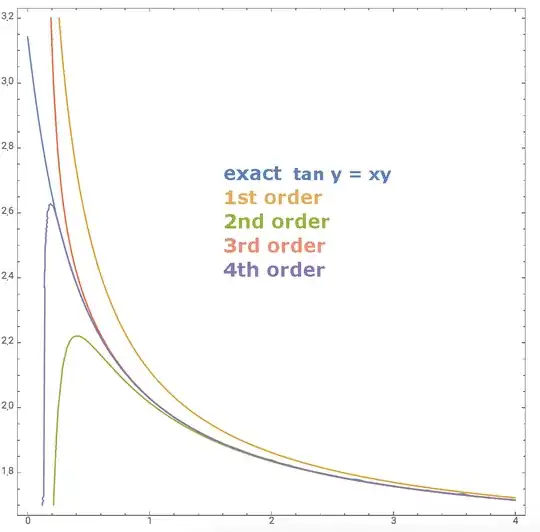

Here is an outline how the problem can be tackled using perturbation theory on a quantum mechanical problem, that is directly related to it.
This is a graphical representation how the perturbation series approaches the exact curve for the first non-trivial non-negative root of (with swapped axis) $$\tan y = -x y$$ (this is the blue "exact" curve) the perturbation series is $$ u(c) = 1+c-c^2\frac{1}{4}+c^3\left(\frac{1}{16}-\frac{\pi^2-9}{48}\right)+c^4\left(-\frac{1}{64} +\frac{\pi^2-9}{192}-\frac{\pi^2-9}{96}+\frac{\pi^2-10}{64}\right) + \mathcal{O}(c^5) $$
The plot shows $$ y(x) = \frac{\pi}{2}\sqrt{u(c\left(\frac{8}{x\pi^2}\right))} $$ to order $n$ in $c^n$ (yellow: $1$ , green $2$, red $3$, purple $4$) and the exact curve $\tan y = xy$ (blue)
<span class=$$ y(x) = \frac{\pi}{2}\sqrt{u(c\left(\frac{8}{x\pi^2}\right))} $$ to order $n$ in $c^n$ (yellow: $1$ , green $2$, red $3$, purple $4$) and the exact curve $\tan y = xy$ (blue)">
