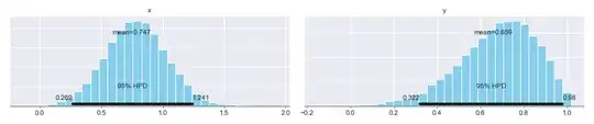

I know this is not the kind answer you are looking for, but you can compute this empirically pretty easily via probabilistic programming. Here is an example with Python and pymc3, taking $E=0.75$ and $V=0.25^2$:
import pymc3 as pm
import numpy as np
with pm.Model() as model:
    x = pm.Normal('x', mu=0.75, sd=0.25)
    y = pm.Deterministic('y', np.sin(x))
    trace = pm.sample(10000)
pm.plot_posterior(trace)
pm.summary(trace)
This snippet will produce a plot showing the distribution of $X$ and $Y=\sin(X)$
posterior
And this table, which shows mean, standard deviation, bounds for the 95% confidence interval, and some diagnostics to make sure the results are reliable (they are):
       mean        sd  mc_error   hpd_2.5  hpd_97.5        n_eff      Rhat
x  0.747098  0.248358  0.003078  0.269450  1.240856  7756.202193  0.999998
y  0.658854  0.178794  0.002208  0.322414  0.980199  7731.781691  1.000049
BlackBear
  • 151
    Actually, I thought of something similar to this previously. I did not follow this approach for 2 reasons: a) I did not know if this was a well-known, trivial problem that could be deterministically solved or not; b) I want to plug this calculation into a fast program, so sampling a lot # of points might slow it down especially when I repeat the operation many times. But nevertheless, your answer is still very helpful. Thanks! – Hùng Phạm Feb 22 '19 at 15:27
