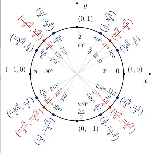

I would be glad if you like! enter image description here
X = COS, Y=SIN
We start by remembering the sequence is simply the Square Root of 0 on 2 (which is just 0) the Square Root 1 on 2 (or 1/2) etc. You write those numbers for 0 degrees, 30,45,60, 90. Then repeat the process back down for the X values.
Once you create the first quadrant (that upper right quarter) the rest just reflect over the X and Y axis. The trig books I see don't spell this out, but when I hand this to a student, and tell them to practice producing that quadrant, they come back a few days later having aced their test, and their friends come ask for a copy of the circle.
