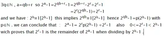

I am having trouble proving this question. Can anyone help me out?

It says dividing by $2^b -$1 – Kath Feb 17 '19 at 11:48
u can start by dividend = divisor*quotient + remainder – ShiS Feb 17 '19 at 12:19

Let $b\equiv r\bmod a$. This implies $a \mid b-r$ and $r<a$. So $2^a-1\mid 2^{b-r}-1$ and hence $2^a-1\mid(2^{b}-1)-(2^r-1)$. Now observe $2^r-1<2^a-1$ and hence the remainder is $2^r-1$.
How do you get from $2^(b-r) -$1 to ($2^b - $1) - ($2^r - $1). These are not the same right? – Kath Feb 17 '19 at 13:14
