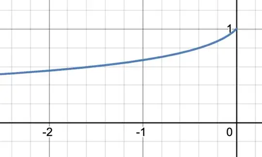

Doing the usual non-rigorous step of interchanging summation and integration gives $$\int_0^\infty \int_0^\infty e^{-(t+t_2)}\sum_{n=0}^{\infty} (tt_2x)^n dtdt_2$$ Simplifying into the geometric series gives $$\int_0^\infty \int_0^\infty \frac{e^{-(t+t_2)}}{1-tt_2x} dtdt_2$$
And indeed evaluating this on Desmos gives $0.6680913637$ at $x=-1$. For any x negative, this integral makes sense and a graph of the integral looks like this enter image description here

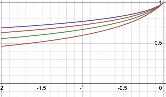

There's also no reason we can't do this same process to get $ \sum_{n=0}^\infty (-1)^n(n!)^k$
For instance, at k=3, we get $$\int_0^\infty \int_0^\infty \int_0^\infty \frac{e^{-(t+t_2+t_3)}}{1-xt_1t_2t_3}dtdt_2dt_3 $$
Interestingly, graphing the different powers of k shows the function converging into the constant y=1 function (k=1 is on the bottom, and k=4 is on top). enter image description here In some ways, this intuitively makes sense. If divergent functions are asymptotic (i.e. able to be approximated by the first few terms in their Taylor series), then a function whose second term goes to infinity must be able to be approximated by just its first term. In general, it does appear that very fast-growing divergent series begin to look like constant series.

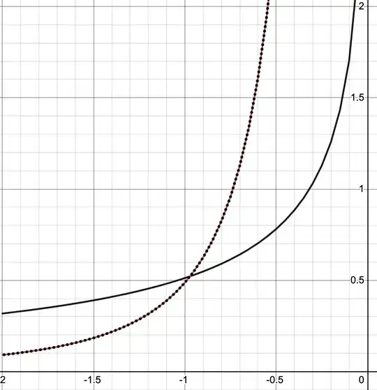

EDIT: I'd like to add a few things I've noticed recently that give an interesting connection between the value assigned to these divergent series and differential equations.
Take the differential equation $$f'' -\frac{1}{x}f - \frac{1}{x^2} = 0$$ We start by assuming that $f$ has the form $f(x) = \sum_{n=0}^\infty a_n x^{-n}$. Formally solving for the coefficents gives $$\sum_{n=0}^\infty a_n (n)(n+1)x^{-(n+2)} = \sum_{n=0}^\infty a_n x^{-(n+1)} - \frac{1}{x^2} \implies a_n = (n-1)!^2 n$$ So the differential equation is formally solved by $$\sum_{n=1}^\infty (n-1)!^2 n x^{-n}$$
Our goal is obtain a value for this divergent series using the divergent series $F(x)=\sum_{n=0}^\infty n!^2 x^{n}$. We can achieve this by doing $G(x)=x\frac{d}{dx}(-xF(x))$, so that $G(\frac{1}{x})=\sum_{n=1}^\infty (n-1)!^2 n x^{-n}$
So, we should have the convergent version of G(x) as $$G(x) = -x\frac{d}{dx}\left(x\int_{0}^{\infty}\int_{0}^{\infty}\frac{e^{-\left(t_{1}+t_{2}\right)}}{1-t_{1}t_{2}x}dt_{1}dt_{2}\right)$$
Therefore, we should expect that our initial differential equation is solved by $f(x) = G(\frac{1}{x})$. And indeed, this is a correct. The graph of f(x) looks like this (the black line in middle if f(x), and the black and dotted line are the $f''(x)$ and $\frac{1}{x}f(x) + \frac{1}{x^2}$ enter image description here Similar differential equations have connections to higher powers of $m$ in $(n!)^m$. For instance, the differential equation $-f'''(x) -\frac{1}{x^2}f(x) - \frac{1}{x^3}=0$ is formally solved by $\frac{1}{x} + \sum_{n=2}^\infty \frac{(n-1)!^3}{2^2}n^2(n+1)x^{-n}$, which may also be obtained from the divergent series $\sum_{n=0}^\infty (-1)^n n!^3 x^n$ in order to find a solution.
