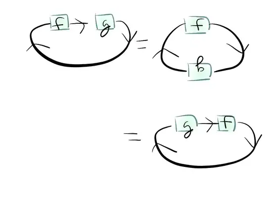

The proof in Martin Brandenburg's answer may look scary but it is secretly about moving beads around on a string. You can see all of the relevant pictures in this blog post and in this blog post. The proof using pictures is the following:
In the first step $g$ gets slid down on the right and in the second step $g$ gets slid up on the left.
