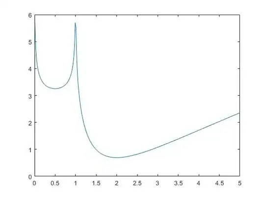

This is not true. Counter-example $x = 0.5$. Also note that: $$f(x) = - \frac{\log(1-x)}{x}$$ $$f(1-x) = - \frac{\log(x)}{1-x}$$ $$f(x)+f(1-x)+\log(x)\log(1-x) =\frac{x(1-x)\log x \log(1-x) -(1-x)\log(1-x) - x \log x}{x(x-1)}$$ which looks like this enter image description here
Ahmad Bazzi
  • 12,238
    I guess the OP is missing a square within the denominator of his series representation for $f(x)$. However, your answer illustrates the problem quite well (+1) – mrtaurho Feb 15 '19 at 12:34
