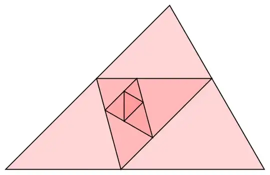

Hmm... This doesn't exactly fit your criterion in that it's not unique to the $45^∘–60^∘–75^∘$ triangle, but the central triangle here has no edges parallel to the edges of the original triangle.
The vertices are: $$ \begin{array}{ccc} \{0,0\} \\ \{1,0\} \\ \left\{\frac{1}{2} \left(3-\sqrt{3}\right),\frac{1}{2} \left(3-\sqrt{3}\right)\right\} \\ \left\{\frac{1}{22} \left(21-2 \sqrt{3}\right),\frac{1}{22} \left(6+\sqrt{3}\right)\right\} \\ \left\{-\frac{3}{22} \left(-5+\sqrt{3}\right),0\right\} \\ \left\{\frac{1}{22} \left(6+\sqrt{3}\right),\frac{1}{22} \left(6+\sqrt{3}\right)\right\} \\ \left\{\frac{1}{286} \left(237-43 \sqrt{3}\right),\frac{1}{143} \left(21-2 \sqrt{3}\right)\right\} \\ \left\{\frac{1}{286} \left(216-41 \sqrt{3}\right),\frac{1}{22} \left(6+\sqrt{3}\right)\right\} \\ \left\{\frac{1}{286} \left(174-37 \sqrt{3}\right),\frac{1}{286} \left(36+17 \sqrt{3}\right)\right\} \\ \left\{\frac{996-197 \sqrt{3}}{1430},\frac{192+43 \sqrt{3}}{1430}\right\} \\ \left\{\frac{996-197 \sqrt{3}}{1430},\frac{306+73 \sqrt{3}}{1430}\right\} \\ \left\{\frac{1}{130} \left(102-19 \sqrt{3}\right),\frac{318+31 \sqrt{3}}{1430}\right\} \\ \end{array} $$

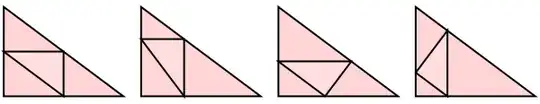

This is based on the three other four-self-similar-triangle dissections beyond the usual midpoints-of-the-sides one:
