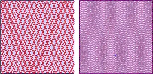

Suppose you start a point-billiard (or light ray) in a square at a random location, shooting off at a random angle, reflecting with angle-of-incidence equals angle-of-reflection. In general, because the point coordinates and direction vector are irrational with probability $1$, the path will fill the square.
          N100_500
          Left: Starting from blue point, $100$ bounces; Right: $500$ bounces.
