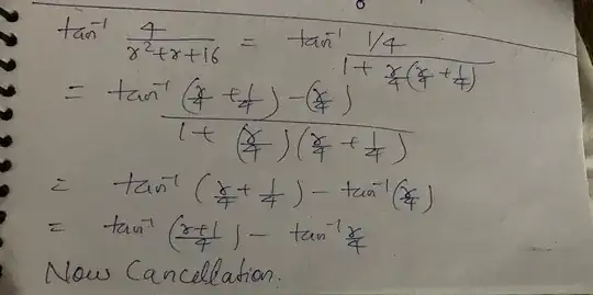

Use $$\arctan\frac{4}{r^2+r+16}=\arctan\frac{\frac{r+1}{4}-\frac{r}{4}}{1+\frac{r+1}{4}\cdot\frac{r}{4}}$$
Check out this solution , hope you understand . Ask if you face any problem
