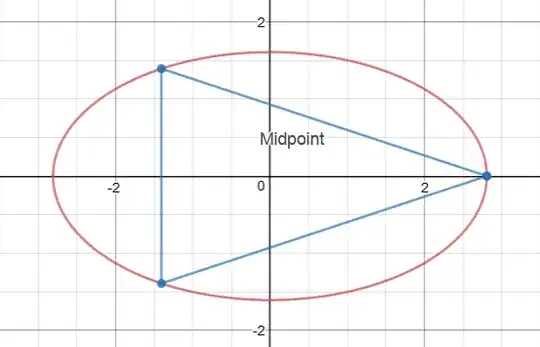

In the given problem one unique vertex is already given $(a,0)$
Lets find the equation of base BC of our Isoceles Triangle with Slope $m$ joining vertex $C(a,0)$ and $B(x_1,y_1)$ which lies on ellipse except the line of symmetry/major axis.
Here how the Step 2 Follows in broad strokes :
  1. Find the solution to other base vertex $B(x_1,y_1)$ in terms of slope $m$ of $BC$
  2. Calculate The length of base BC.
  3. Find the the solution to altitude vertex in terms of slope $m$ of base $BC$
  4. Calculate the length of Altitude
  5. Put the terms in Area formula($\Delta$) and evaluate $$ \frac{d \Delta}{dm} = 0 $$
Solution to the Base Vertex
$b \sqrt{1-(\frac{x_1}{a})^2} = m(x_1-a)$ - (i)
$b^2(1-(\frac{x_1}{a})^2) = m^2(x_1-a)^2$ - (ii)
Solving further:
$$\frac{x_1}{a} = \frac{(am)^2 - b^2}{(am)^2 + b^2}$$ -(iii)
Calculating the Base length
$L^2 = (x_1 - a)^2 + (y_1-0)^2$
$L^2 = (\frac{y_1}{m})^2 + (y_1)^2$ -- using (ii)
Solving further((iii) is used between the skipped steps):
$$L = \frac{2ab^2}{(am)^2 + b^2}(\sqrt{1+m^2})$$
Solution to the Altitude Vertex
  1. Find Normal To the base $BC$ , passing through its midpoint.
  2. Solve The Simultaneous Equations of Normal and ellipse
Midpoint $(\frac{x_1+a}{2},\frac{y_1}{2})$
$y - y_1 = -\frac{1}{m}(x-\frac{x_1+a}{2})$
Solving further using (iii) :
We can write the equation in compact and elegant form:
$Q=\frac{am^2(a^2-b^2)}{(am)^2+b^2}$
$$ y = \frac{(Q-x)}{m}$$
Brace yourself for the upcoming monstrosity
Solving the simultaneous equations lead to very untenable solution to Altitude vertex A$(x_a,y_a)$
$m^2y^2 = Q^2+ x^2 - 2Qx$
$m^2b^2(1- (\frac{x}{a})^2) = Q^2+ x^2 - 2Qx$
$$ x_a = \frac{Q \pm \frac{mb\sqrt{a^2+(mb)^2 - Q^2}}{a}}{1 + (\frac{mb}{a})^2}$$

EDIT: Diagrams are added!

You can think of an ellipse with semi-major axis $a$ and semi-minor axis $b$, as a circle of radius $a$ which is then "squeezed" by a ratio $b/a$ along the direction of minor axis. Any polygon inscribed in the circle becomes then a polygon inscribed in the ellipse, and its area changes by the same ratio $b/a$.
But we know that the triangle of maximum area inscribed in a circle is any equilateral triangle (see here for a proof), having an area of ${3\sqrt3\over4}r^2$. It follows that any triangle of maximum area inscribed in the ellipse described above has an area of ${3\sqrt3\over4}ab$ and must the image of an equilateral triangle after squeezing.
Among these triangles, there are only four isosceles triangles: they are the image of those equilateral triangles in the circle of radius $a$ having a vertex either on the minor axis, or on the major axis, for in that case two sides ares stretched by the same amount.
