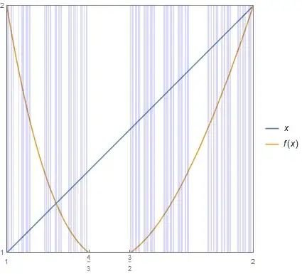

The following figure is a visualization of this phenomenon. It is the plot of both $y = x$ and $y = f(x)$ within the region $[1,2]\times[1,2]$, together with thin blue rectangles representing the set $f^{-7}([1,2])\times[1,2]$.

    So , this problem looks deceptively simple , but it turns out that it is quite a hard nut to crack . After running $C$ codes to check behaviour of this sequence , I find it highly likely that $x_0$ is not in $\bigcap_{n=0}^{\infty} f^{-n}([1,2])$ – John Feb 07 '19 at 02:35
  • @John Indeed I also suspect that $K$ has zero Lebesgue-measure, much like the original Cantor set, so that for almost every starting point $x_0$ in $[1, 2]$ the sequence will diverge to $+\infty$. But I have no good idea for proving (or disproving) this. – Sangchul Lee Feb 07 '19 at 03:32
