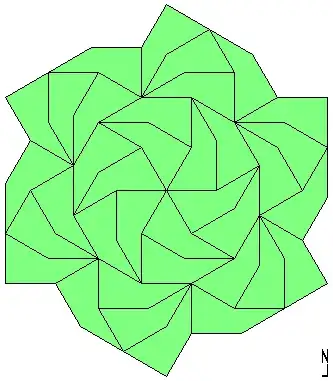

For example, $(\Bbb Z_3, +_3)\cong H$, where $H=(X, \circ')$, for $X=\{\operatorname{id}, \sigma^2, \sigma^4\}$, is the subgroup of the group $(\{\sigma^i\mid i\in\overline{0,5}\}, \circ)$ of the rotational symmetries of this shape:
Symmetric tiling under Z_6,
where $\sigma$ is a clockwise rotation of $\pi/3$ radians about the centre, so that $\circ'=\circ\rvert_{X\times X}$ is distinct from addition $+_3$ modulo $3$.
Note that here we have simply declared that $\circ'$ is some restriction but $+_3$ is not (although it can be seen as such); also, $\circ'$ is composition of functions, whereas $+_3$ is an arithmetical operation.
