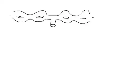

Suppose $M$ is a connected, noncompact 2-manifold, and its boundary $\partial M$ is a circle. What's the simplest way to show there is a retraction $r: M\rightarrow \partial M$?
Here are some examples of such surfaces:
  1. Probably the easiest example is the closed unit disk, minus the origin.
  2. A more complicated example is the closed unit disk minus a Cantor set.
  3. A totally different example is to join two infinite-genus tori, and attach a cylinder to that: infinte genus tori with boundary
