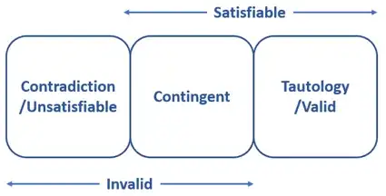

Now to get hold of the connection between all these terms. I prepared below figure:
Next as stated in this comment, "Not a typeX" has two meanings: (1) "The negation of a typeX" and "Not a statement that can be categorized as a typeX".
So, with this in mind, I came up with following relations:
  1. $¬$ tautology $=$ $¬$ valid $=$ contradiction $=$ unsatisfiable
  2. $¬$ contradiction $=$ $¬$ unsatisfiable $=$ tautology $=$ valid
  3. Not a tautology $=$ not a valid $=$ invalid $=$ can be either contradiction or contingent
  4. Not a contradiction $=$ not an unsatisfiable $=$ satisfiable $=$ can be either tautology or contingent
  5. (contradiction $=$ unsatisfiable) $≠$ $¬$ satisfiable $=$ invalid $=$ can be contradiction or contingent
  6. (tautology $=$ valid) $≠$ $¬$ invalid $=$ satisfiable $=$ can be tautology or contingent
  7. Not an invalid $=$ valid $=$ tautology
  8. Not a satisfiable $=$ unsatisfiable $=$ contradiction
Above,
  • $\neg$ means "negation" (or I dont know if it will be more correct or will add more sense if I say a "Boolean negation")
  • "Not a TypeX" means statement "cannot be categorized as TypeX"
  • $=$ simply means "is"
  • $\neq$ simply means "is not"
I know these are pretty much basic stuff but was source of a lot of confusion for me and I wanted all these related things noted down at one place in correct way. Can anyone confirm if above bullet points and figure are correct?

Consider first the negation of the definition of tautology :
A formula $\varphi$ is a tautology iff is true in every possible interpretation.
We can re-write it as follows : for every interpretation $\mathfrak I$, the formula $\varphi$ is true.
Thus, its negation is : there is an interpretation $\mathfrak I_0$ such that the formula $\varphi$ is not true, i.e. false.
But, to say that the formula is false for some interpretation does not imply that it is false for every interpretation.
Conclusion :
a formula that is not a tautology can be either unsatisfiable or satisfiable.
Different is the case with the negation of a formula $\varphi$.
If $\varphi$ is a tautology, then it is true for every interpretation.
Thus, its negation $\lnot \varphi$ is false for every interpretation.
Conclusion :
if $\varphi$ is a tautology, then $\lnot \varphi$ is unsatisfiable, i.e. a contradiction.
In this way, we have covered all cases :
tautology (aka : valid), unsatisfiable (aka : contradiction), satisfiable.
  • I believe your first conclusion is my point 3 in doubt section of question. The only thing I missed to state "explicitly" in point 3 is that it can also be satisfiable (even thought I have specified contingent in point 3, which is also satisfiable). Same is case with your conclusion 2, which I feel is exactly same as my point 1 in doubt section of question. Right? – RajS Jan 21 '19 at 12:17
  • @anir - contingent is an "old" term : "neither true under every possible valuation (i.e. tautology) nor false under every possible valuation (i.e. contradiction)." Thus, according to this def, a contingent proposition cannot be a contradiction, and thus cannot be unsatisfiable. – Mauro ALLEGRANZA Jan 21 '19 at 12:31
  • Regarding your points, the gist of my long comemnt is : it is not necessary (and it can be misleading) to consider all the above cases, when we have only three basic terms in place : tautology/satisfiable/ contradiction. Then we can easily apply them to a formula starting with a negation sign. – Mauro ALLEGRANZA Jan 21 '19 at 12:34
