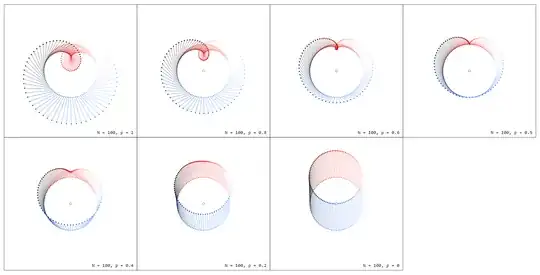

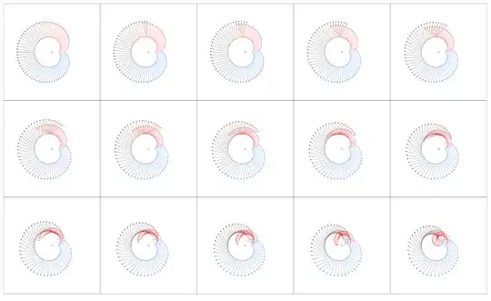

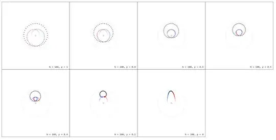

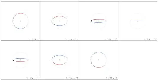

Consider the unit circle $C_1$ in $\mathbb{C}$ with $n$ equally distributed numbers $z_k = e^{i2\pi k/n}$. Draw from each $z_k$ an arrow to $z_k + f(z_k)$ for $f(z) = z$ resp. $f(z) = 1/z$. To make the connection between $z$ and $1/z$ more comprehensible I plot the graphs $f_p(z) = pz + (1-p)/z$ for some values of $0 \leq p \leq 1$. Note that $f_1(z) = z$ and $f_0(z) = 1/z$.
enter image description here[click image to enlarge]
Note that these plots are essentially stream plots a) restricted to the unit circle and b) displaying not only the direction of the vector field but also its magnitude.

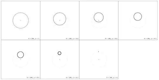

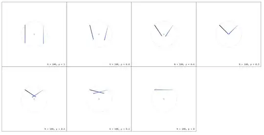

Note that by $f_p(-z) = -f_p(z)$ we have $\sum_{k=0}^{n-1}f_p(z_k) = 0$ for all $p$ which can more easily be seen when drawing $f_p(z)$ from the origin:
enter image description here Note the difference in color between $f_1(z) = z$ and $f_0(z) = 1/z$ which is due to different phases $\varphi = 2\pi k/n$ of the arguments.
Now let's consider the factor $d_nz$, which is the secant (for $n\rightarrow \infty$ the tangent) vector of the circle at point $z$. Multiplying $f(z)$ by $d_nz$ shrinks and rotates $f(z)$. Because $|d_nz|\rightarrow 0$ for $n\rightarrow\infty$, we would have $|f(z)d_nz| \rightarrow 0$, too, so to keep the vector $f(z)d_nz$ visible, we normalize $d_nz$ by division by $|d_nz| = 2\pi/n$. So, only the rotation of $f(z)$ is in the focus:
Now we are already done: For $f(z) = f_1(z) = z$ the vectors $f(z_k)dz$ still sum up to $0$, while for $f(z) = f_0(z) = 1/z$ we have $n$ vectors of length $1$ all pointing into the same direction (up), so there sum is just $n\cdot i$. Multiplying by the normalization factor $2\pi/n$ we get the desired result:

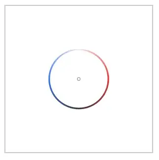

Again, to see this more clearly, we can draw $f(z)d_nz$ from the origin:
Note that the single point for $p=0$, i.e. $f_0(z) = 1/z$, represents in fact $n$ points, all at the same position.

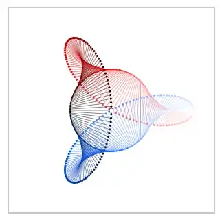

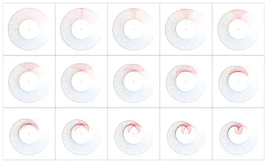

Dirk asked for pictures for $f(z) = 1/z^2$. Here they are for $z \rightarrow z + f(z)$, $z \rightarrow z + f(z)d_nz$, , $0 \rightarrow f(z)d_nz$:
enter image description here enter image description here enter image description here

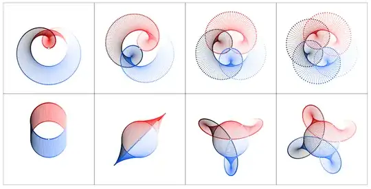

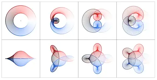

For the sake of comparison here are the plots for $f(z) = z^k$, $k = 1,2,3,4$ (upper rows) and $f(z) = 1/z^k$ (lower rows):
Note the special character of the bottom left plot in the second picture which is the one that relates to the residue of $z^{-1}$ at $z=0$ being $1$. All other residues of $z^{\pm k}$ at $z=0$ are $0$.
Note also how derivation acts as rotation.

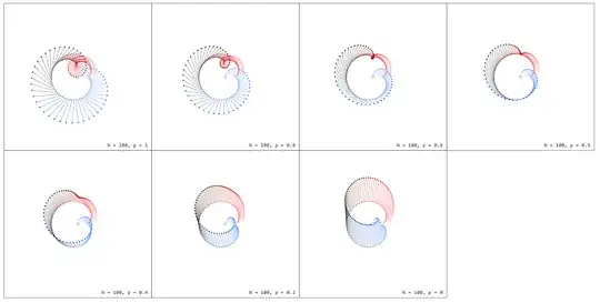

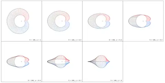

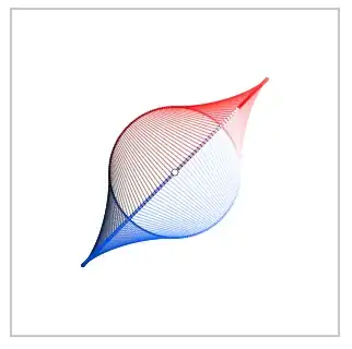

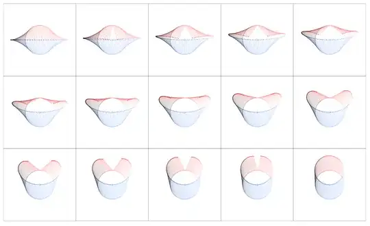

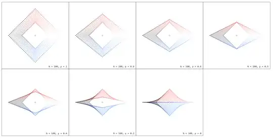

For the sake of comparison: The same visual proof works – even though not so easy to see at a glance – for other closed curves, e.g. a cardioid $\gamma$. In the first table you'll see $z \rightarrow z + f(z)$, in the second $z \rightarrow z + f(z)d_nz$, in the third $0 \rightarrow f(z)d_nz$. With a little experience you will "see" that $\oint_\gamma zdz = 0$ and $\oint_\gamma dz/z = 2\pi i$

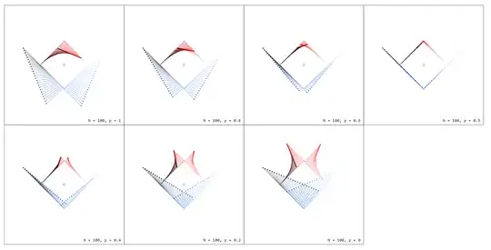

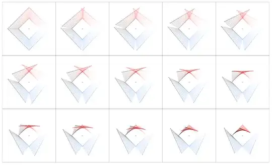

And here for the diamond curve: the tables for $z \rightarrow z + f(z)$, $z \rightarrow z + f(z)d_nz$, and $0 \rightarrow f(z)d_nz$
The rotation of $f(z)$ as induced by multiplication by $dz$ can be seen as a "process" in stop motion:
enter image description here Note that in these two cases – based on the circle – $f(0)$ is rotated by $\pi/2$, $f(e^{i\pi/2})$ by $\pi$, $f(e^{i\pi})$ by $-\pi/2$, and $f(e^{i3\pi/2})$ by $0$.
