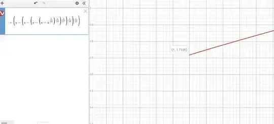

  • Here is a plot of $f_{19}$. We can see that as $x\to 1^+$, $\min f_{19}\to 1.7186$ which is strange as the denominator can only take the binary values $0$ or $1$ at $x=1$. The curve is monotonically increasing from $1$ onwards, which is expected as the numerator dominates.
