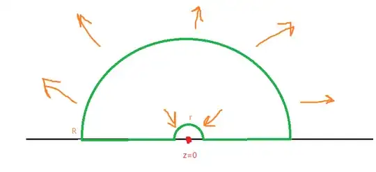

Usually you'd need this kind of contour if you happen to have poles on the real axis. We take the small radius $r\to 0$ and the large radius $R\to\infty$. The value on the bigger half circle should decay fast enough so the value of the integral would depend on the limit of the smaller half circle.
You can see this example of a similar calculation.

  • You should probably mention explicitly that if $f==1/z^2$ then the integral over the smaller half-circle does not tend to $0$ as $r\to0$. – David C. Ullrich Jan 17 '19 at 15:13
