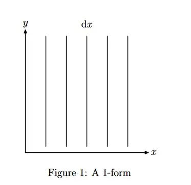

I think I understood 1-forms fairly well with the help of these two sources. They are dual to vectors, so they measure them which can be visualized with planes the vectors pierce.

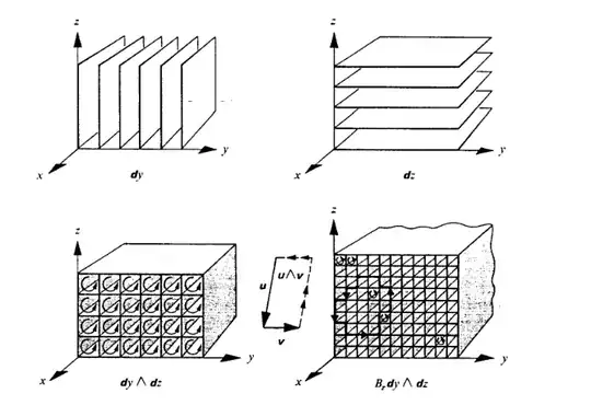

  1. How can I visualize the wedge between two 1-forms $\alpha\wedge\beta$? I think I understood the wedge between two vectors, as the parallelogram created by the two in a "area sense". The determinant comes in to make it only about the area which is why $v\wedge w = \frac{1}{2}v\wedge 2w$ since stretching the parallelogram by two in the w direction is compensated by squishing it in the v direction, so the area stays constant. So the wedge between two vectors is the area it spans with its vectors. But how does that translate to the dual space? Where 1-forms measure the length of the component of its dual vector. And can be visualized as planes the vectors pierce through. What is the visualization between two of these 1-forms as a wedge?

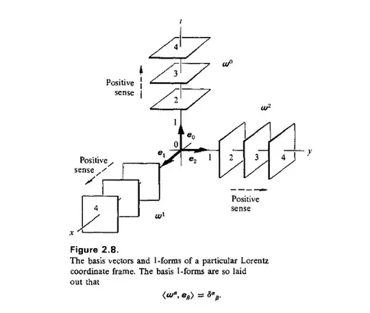

Gravitation has this picture:

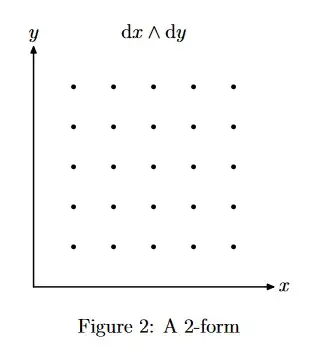

2-forms Dan-Piponi drew it like this:
2-forms dan
Now these pictures make some sense as they are generated by intersecting the 1-forms. But I am not quite getting how the result is evaluated. The result (2-form) should map two vectors as input to a number. And I don't see how these intersections do that. While for 1-forms you count the numbers of planes a vector pierced.

First we need to understand what the wedge actually does. In your case it creates a new fully anti-symmetric tensor (think determinant) of order 2. A 2-form is a thing that takes two vectors and returns a scalar. If, for example, we plug a vector into a 1-form we get a number. We also know that forms are multi-linear, therefore we can pull out all the factors and apply the form on each basis-vector individually. So in practice a 1-form just projects a vector and measures the length of that projection. Following this, a 2-form can be visualized as a thing that first takes a vector and becomes a 1-form.
But how does that translate to the dual space? What is the visualization between two of these 1-forms as a wedge?
Let's say we are in $\Lambda(\mathbb{R}^3)$, your 2-vector $a \wedge b$ can be thought of as something with the magnitude of the enclosed parallelogram of $a,b$ and an additional other property - path orientation. These two properties are taken by the 2-form to return a number. You might get the impression that this looks very similar to integration, and you would be right. The way they scale and how they compute vectors is exactly how integration works.
