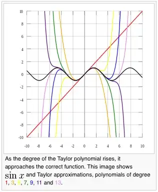

The other answers are very nice. I'd just like to add how this works, because it's very nifty and somewhat surprising if you see it the first time. Look at the series definition of $\exp(x)$:
$$ \exp x = \sum_{k=0}^\infty \frac{x^k}{k!} = 1 + x + \frac{x^2}{2} + \frac{x^3}{3!} + \ldots $$
When $x$ is real, this has a fairly simple behavior, it grows monotonously. However, if you allow complex numbers, you can get minus signs in there because of $i^2 = -1$. Let $x = i\alpha$, and then:
$$ \exp i\alpha = \sum_{k=0}^\infty \frac{(i\alpha)^k}{k!} = 1 + i\alpha - \frac{\alpha^2}{2} - i\frac{\alpha^3}{3!} + \frac{\alpha^4}{4!} + i\frac{\alpha^5}{5!} + \ldots $$
Two interesting things happen:
  • All odd powers of $\alpha$ get an $i$, while all even powers are real (because $i^2$ is real). This lets you single out the even part (symmetric to the Y-axis), and the odd part (point symmetric wrt. the origin) of the function.
  • Every two terms the sign switches, so you no longer have unbounded growth, but can have periodicity.
If you collect all the odd terms, which are imaginary, you get:
$$ \mathrm{Im}\,(\exp i\alpha) = \alpha - \frac{\alpha^3}{3!} + \frac{\alpha^5}{5!}- \frac{\alpha^7}{7!}\pm \ldots = \sin \alpha $$ and this happens to be exactly the Taylor expansion of $\sin\alpha$! You start with the value of $\sin(0)=1$ as a first approximation, and keep adding Taylor terms. Since $\sin'0 = \cos 0 = 0 $ there is no $\alpha^1$ term, but $\sin''0 = -1$, so the $\alpha^2$ term is negative, and so on. Every term flips the sign and adds two bends, and you approximate $\sin \alpha$ better and better. A nice picture from the wikipedia article Taylor series:
All the even power terms are real, and they give $\cos \alpha$:
$$ \mathrm{Re}\,(\exp i\alpha) = 1 - \frac{\alpha^2}{2!} + \frac{\alpha^4}{4!} -\frac{\alpha^6}{6!} \pm \ldots = \cos \alpha $$
Which allows you to write the nice formula of Euler:
$$ \exp i\alpha = \cos \alpha + i\sin \alpha $$
As already said in the other answers, you can think of $\alpha$ as the angle from the x-axis (counterclockwise). Since for complex numbers, conventionally $z= x + iy$, it follows that $x = \cos \alpha$ and $y = \sin \alpha$. If I'm doing e.g. some computer graphics calculations, often all I need to remember is "$x = \cos$" and all else falls into place. Another Wikipedia illustration of this:

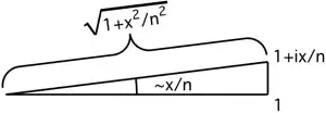

In this answer, I show that $$ e^{ix}=\lim_{n\to\infty}\left(1+\frac{ix}{n}\right)^n=\cos(x)+i\sin(x) $$ using the geometric properties of complex multiplication. It is argued there that, as shown in this answer, since $$ \lim_{x\to0}\frac{\tan(x)}{x}=1 $$ and $$ \lim_{n\to\infty}\left(1+\frac{x^2}{n^2}\right)^{n/2}=1 $$ that the product of $n$ copies of $1+ix/n$
$\hspace{5cm}$enter image description here
that is, $$ \lim_{n\to\infty}\left(1+\frac{ix}{n}\right)^n $$ has length $1$ and argument $x$, which means that it equals $$ \cos(x)+i\sin(x) $$
