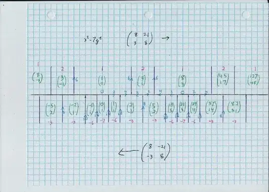

Well, why not. It is unusual to get just a single one of these formulas: all solutions are given by arbitrary integer $n$ and $$ \left( \begin{array}{c} x_n \\ y_n \end{array} \right) = \left( \begin{array}{cc} 8 & 21 \\ 3 & 8 \end{array} \right)^n \left( \begin{array}{c} 3 \\ 1 \end{array} \right) $$
This leads to a single pair or Fibonacci type recurrences, $$ x_{n+2} = 16 x_{n+1} - x_n, $$ $$ y_{n+2} = 16 y_{n+1} - y_n. $$ These begin with $x_n$ as $$ 3, 45, 717, 11427, 182115,... $$ and $y_n$ in $$ 1, 17, 271, 4319, 68833,... $$

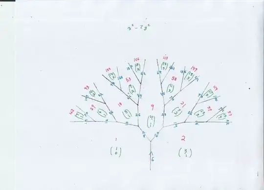

Just drew this, the tree below shows several of the small positive numbers that are primitively represented as $x^2 - 7 y^2,$ primitive meaning $\gcd(x,y) = 1.$ For most of these numbers, just one represention (green xy pair) is shown, so usually at least one more diagram will be needed to produce the recurrences. enter image description here

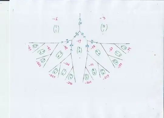

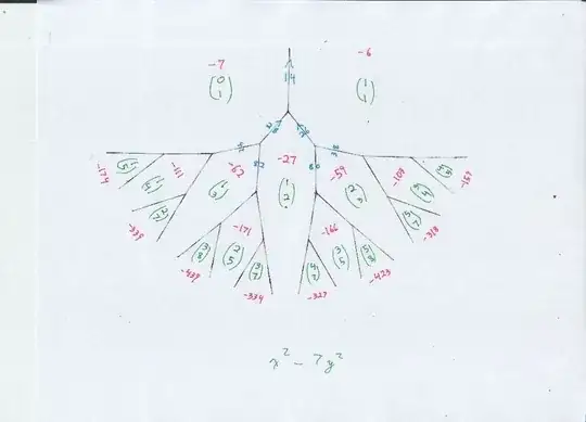

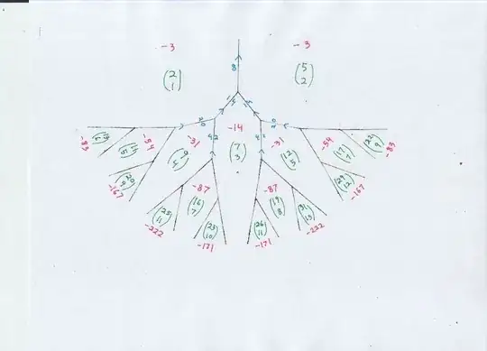

Here is one of the diagrams showing negative values of $x^2 - 7 y^2,$ therefore dropping downwards from the original "river" diagram. Also, while the light blue edge labels are important numbers, I am beginning to see why most authors do not draw them in the diagrams, they do clutter the picture. Also, when drawing one of my "tree" diagrams, it is obvious which way the blue arrows must point. I imagine I will draw in the first few blue edge labels..
enter image description here enter image description here Notice how, because of the symmetry $-3,-3$ at the "trunk" of the tree, all the values except the central $-14$ have two expressions within the diagram, thereby emphasizing that those values would need more than one orbit of recurrences (to parametrize all expressions as $x^2 - 7 y^2$) enter image description here
