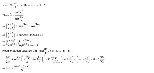

Here I came up with a solution involving only elementary calculation, I hope it's appreciable...
(Sorry as it's in image form)
soln
