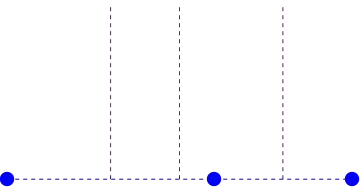

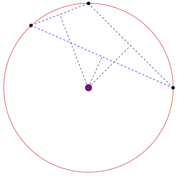

Sometimes a few figures are worth a thousand words:
Top: Three non-collinear points determine a triangle, each leg of which will be a chord of the circle. A perpendicular to each chord must go through the center of the circumscribed circle.
Bottom: If the three points are collinear, then perpendiculars to their three defined segments are parallel, thus never meet, thus cannot define a circle.
Clear?
  • I assume the lower image is when you collapse the shorter 2 legs of the triangle onto the longest leg of the triangle? (and the resulting vertical lines in the lower image are where the bisecting lines in the upper image would land) What is the significance of "collapsing two lines on to one line" ... i.e. why did you choose to emphasize this? – S.C. Jan 06 '19 at 00:09
  • When the three (blue) points are linearly dependent (i.e., you can obtain one of the points by a linear combination of the two others), the points fall on a line (hence "linear") and the bisecting perpendiculars which intersect at the center of the generated circle, instead do not intersect... hence no circle... hence no solution. – David G. Stork Jan 06 '19 at 00:13
