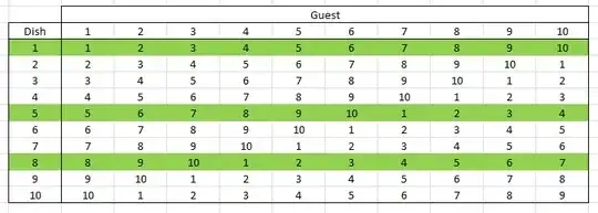

Let's look at a concrete example. Suppose the number of possible dishes was $D=10$, the number of selected dishes was $d=3$ and the number of guests was $n=10$. The worst possible ranking I can think of (though I'm not sure it is the worst) is shown below:
enter image description here The ranks are spread out so no guest ranks any dish the same.
I now selected the $3$ dishes marked in green so that the ranks of $1,2, 3$ were distributed among the guests as much as possible. Thus, only guest $10$ does not have one of the selected dishes in his top $3$.
If you now go through each of the unselected dishes, you will see that in every case a majority of the guests will have a higher ranked dish among the $3$ selected dishes.
So (assuming my worst case actually is the worst case!) with these values of $D$, $d$ and $n$, it is always possible to select such a menu.
Any input as to whether a worse case ranking is possible, would also be appreciated.

  • Thanks. Your strategy appears to give an upper bound for $d$ (or $f_n(D)$ as you call it). Do you agree? Also, how do you know the strategy for $n$ odd won't result in ties? – Jens Jan 09 '19 at 03:29
  • @Jens My strategy basically says you can succeed as long as $d$ is at least as those bounds. If a tie between x and y occurred, it would mean the number of people who preferred x to y would equal the number of people who preferred y to x. Those two numbers add up to $n$, implying $n$ is even (unless I am mistaken again). – Mike Earnest Jan 09 '19 at 05:40
  • But look at my example in the OP. I know it has an even number of people, but it could easily be extended to $11$ people and $11$ dishes. Wouldn't every dish get the same rating in your system? – Jens Jan 10 '19 at 00:20
  • Oh, I was confused as to what you mean by ties. In the case of a tie, you arbitrarily choose a dish $x$ to put on the menu. In your example, every dish gets 5 points, and $5\ge (D-1)/2=(11-1)/2$. Therefore, you arbitrarily choose some dish x to put on the menu, remove all the dishes x beats, then recurse. – Mike Earnest Jan 10 '19 at 00:27
  • OK, I understand. Thanks. – Jens Jan 10 '19 at 00:47
