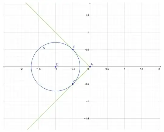

Let us think of complex plane. I used the program, GeoGebra to draw the figure below.
Let $A = 0$, $B = -0.5+0.5i$, $C = -0.5 -0.5 i$, and $D=-1$.
Your first inequality is true if and only if $z$ is on the circle or outside the circle.
Thus it is enough to show that if $z$ is in the circle, then that $z$ satisfies the second inequality.
The circle is between the half-line $\overrightarrow{AB}$ and $\overrightarrow{AC}$.
The angle of $\overrightarrow{AB}$ is $\frac{3\pi}{4}$, and the angle of $\overrightarrow{AC}$ is $\frac{5\pi}{4}$.
Generally, assume that $z$ is a complex number between these two half-line.
We know that the angle of $z^2$ is twice of the angle of $z$.
Thus the angle of $z^2$ is between $\frac{3\pi}{2}$ and $\frac{5\pi}{2}$.
It means that the real part of $z^2$ is non-negative.
Thus, the real part of $z^2 +1$ is greater than or equal to $1$.
Because $|z^2 + 1| \geq |Re(z^2 +1)|$, it follows that $|z^2 + 1| \geq 1$. Q.E.D.
figure in complex plane
I think that this geometric proof let us be able to make similar problems.
