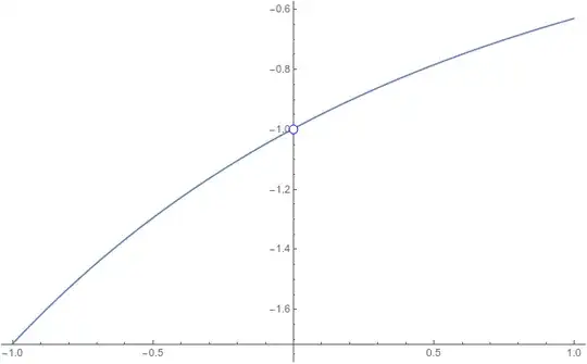

Let's plot $\frac{\mathrm{e}^{-h} - 1}{h}$ versus $h$. Plot of expression
This graph contains all the information of the rate of change as we vary $h$. Notice, there is a hole in the graph at $h = 0$, because division by zero is undefined. However, it is quite clear what value the continuous extension of the function to include $h = 0$ is, $-1$.
If I ask you for an average rate of change, I have to tell you $h$ so that you know which point from this graph to report. If I ask you for the average rate of change when $h=0$, that is undefined (again, because division by zero is undefined). But if I ask you what it would be, the answer is $-1$, as we can easily see. So the average rate of change when $h=0$ is undefined, but the instantaneous rate of change can be defined, using the limit as $h \rightarrow 0$ of the average rate(s)${}^*$ of change, and has a definite value.
