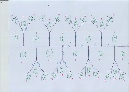

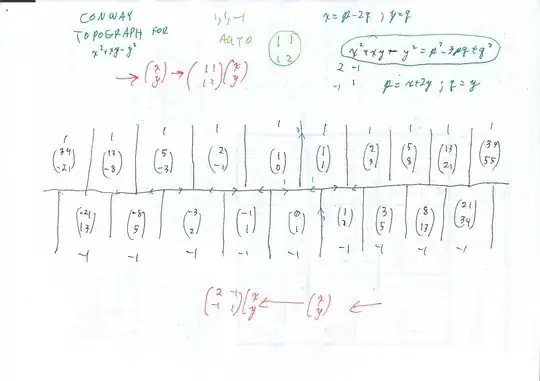

I can recommend Weissman for the Conway topograph. Domain topograph page 233, automorphisms page 240, range topograph page 244, the river is periodic page 286. I'm not seeing an explicit statement that the "automorphism" generator can be seen if we draw the "domain" and "range" topographs together, as I do. Implicit, certainly. Note: I had not noticed that Weissman writes the "domain" vectors as rows. I have always drawn them as columns. So, my automorphism matrix is two columns side by side.

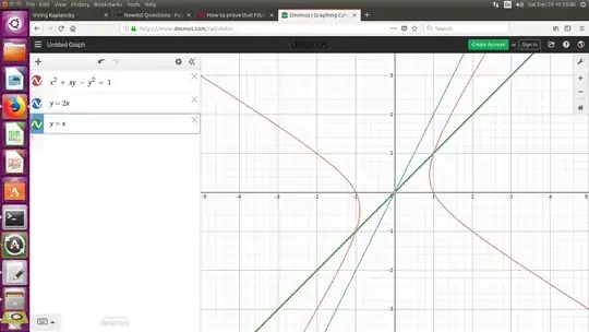

The attitude of Hurwitz (1907) is what they are trying to get across. A solution $(x,y)$ with $x,y > 0$ and $x^2 + xy - y^2 =1$ will be called "fundamental" if the backwards move $$ (x,y) \mapsto (2x-y, -x+y) $$ leads to one or both elements negative or zero: either $$ 2x-y \leq 0 \; \; \mbox{OR} \; \; -x+y \leq 0 $$ As this diagram shows, we never get $y \geq 2 x$ on the hyperbola part within the first quadrant. We do get $y \leq x,$ namely the solution $(1,1)$ is moved "backwards" to $(1,0)$ The simple result is that all positive solutions are found by beginning with $(1,1)$ and repeatedly moving forwards to $$ (x,y) \mapsto (x+y, x+2y) $$ This mapping is the generator of the (oriented) automorphism group of the quadratic form. The generator can be seen in my diagrams of the Conway Topograph method (columns in green in the later diagram).
The matrix is $$ A = \left( \begin{array}{rr} 1&1\\ 1&2 \end{array} \right) $$ Cayley-Hamilton tells us, from $A^2 - 3A + I + 0$ or $A^2 = 3 A - I\; , \;$ that $$ x_{n+2} = 3 x_{n+1} - x_n, $$ $$ y_{n+2} = 3 y_{n+1} - y_n. $$
If you don't know Cayley-Hamilton, just solve: $$ x_{n+2} = x_{n+1} + y_{n+1} = (x_n+y_n) + (x_n + 2 y_n) \; , \; $$ $$ x_{n+2} = 2 x_n + 3 y_n \; , \; $$ $$ 3 x_{n+1} = 3 x_n + 3 y_n \; , \; $$ $$ x_{n+2} - 3 x_{n+1} = - x_n \; . \; $$
enter image description here enter image description here enter image description here
