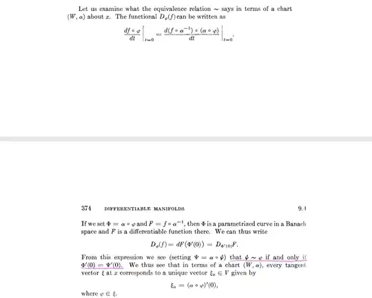

I am currently reading through the section in Loomis and Sternberg's Advanced Calculus (Revised Edition) on tangent spaces, but I'm having trouble justifying one step of the argument (on pp. 373-374, shown below).
Here are the definitions and notations used by them. Let $M$ be a differentiable manifold (here they model their manifolds on a Banach space $V$ rather than some $\mathbb{R}^n$). Let $x \in M$, and let $\varphi : I \to M$ be a differentiable map where $I$ is an interval in $\mathbb{R}$ containing $0$, and $\varphi(0) = x.$ Then, they define an operator $D_{\varphi}: C^{\infty}(M) \to \mathbb{R}$ by $D_{\varphi}(f) = (f \circ \varphi)'(0)$. Next, they define an equivalence relation on all the curves passing through $x$ by $\varphi \sim \psi$ if and only if $D_{\varphi} = D_{\psi}$, and call an equivalence class of curves, $\xi$ to be a tangent vector at $x$.
So far so good. Next, they go to a chart $(W, \alpha)$, and the underlined section below is what I don't fully understand. I get that $\varphi \sim \psi$ if and only if for every $f \in C^{\infty}(M)$, $d(f \circ \alpha^{-1})_{\alpha(x)}((\alpha \circ \varphi)'(0))$ $= d(f \circ \alpha^{-1})_{\alpha(x)}((\alpha \circ \psi)'(0))$. But I don't see how to conclude from here that the two vectors $(\alpha \circ \varphi)'(0)$ and $(\alpha \circ \psi)'(0)$ are equal.
I'm guessing it has something to do with the fact that the two derivatives are equal for every $f$; if we somehow choose an $f$ such that the differential $d(f \circ \alpha^{-1})_{\alpha(x)} : V \to \mathbb{R}$ is injective, then its kernel is $\{0\}$, and thus equality follows. However I doubt this is always possible, since in general $\dim(V) > 1$, so a linear map from $V$ to $\mathbb{R}$ cannot be injective.
Any help justifying this step is much appreciated.

The differential does not have to be injective. Note that for any vector space $W$, $\phi(v) = 0$ for any linear functional $\phi$ on $W$ implies that $v = 0$ necessarily. Therefore, since $\mathrm{d}F$ is always a linear functional regardless of the choice of $f$, you simply need to show that you can obtain any linear functional on $V$ with an appropriate choice of $f$.
For the sake of closure, here are some further details (though probably by now this question is resolved).
First note that by the definition of the $C^\infty$ (hence $C^1$) structure on $M$ the map $C^1(M;\mathbb{R})\to V^\ast$, $f\mapsto (f\circ\alpha^{-1})'(\alpha(x))$ is onto, where $V$ is the Banach space that is the local model for $M$. (Of course the map is not injective, as functions that have "contact of order $1$" at $x$ will produce the same topolinear functionals). As a consequence of the Hahn-Banach theorem $V^\ast$ separates points of $V$ (see e.g. When does $X^\star$ separate the points of $X$?), from which the statement follows.
