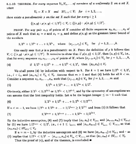

To construct a metric $\rho$ in which $A$ is not contained in any ball we formulate an unbounded counterpart of a fundamental Theorem 8.1.10 from Engelking’s “General topology” (2nd edn.).
Lemma. For every sequence $\{V_i:i\in\Bbb Z\}$ of symmetric members of a uniformity $\mathcal U$ on a set $X$, where $V^3_{i+1}\subset V_i$ for each $i$ there exists a function $\rho$ on the set $V=\bigcup V_i$ such that
(i) For each $x\in X$ we have $(x,x)\in V$ and $\rho(x,x)=0$.
(ii) For each $(x,y)\in V$ we have $(y,x)\in V$ and $\rho(x,y)=\rho(y,x)$.
(iii) For each $(x,y),(y,z)\in V$ we have $(x,z)\in V$, and $\rho(x,z)\le \rho(x,y)+ \rho(y,z)$.
(iv) For each $i$ we have $\{(x,y):\rho(x,y)<1/2^i\}\subset V_i\subset \{(x,y):\rho(x,y)\le 1/2^i\}.$
The proof of Lemma is almost the same as that of Theorem 8.1.10, so we skip it.
