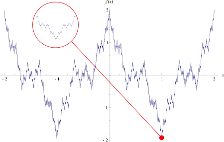

The Weierstrass function provides an example of a function that is continuous but not convex or concave in any open neighborhood.
The reason being that it has infinitely fine oscillation everywhere (since it is a fractal). It is defined by the infinite series $$ f(x):=\sum_{n=0}^\infty a^n \cos(b^n \pi x) $$ where $a,b\in \Bbb R$ satisfy certain assumptions. You can read more about it in the wikipedia link I provided.
To see why this function has such properties, we recall that if $f$ is convex/concave, then it is (locally) Lipschitz. However, Rademacher's theorem says that a Lipschitz continuous function is differentiable almost everywhere, which contradicts the fact that our $f$ is nowhere differentiable.
