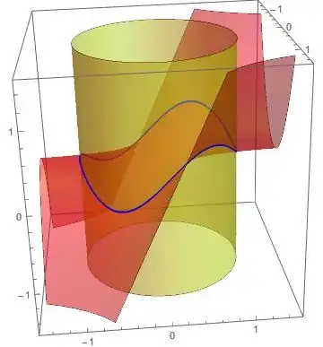

Some geometric ideas
In the attached plot we have in light red the surface $S_1(x,y,z) = x^2 y-z = 0$ and in light yellow the surface $S_2(x,y,z) = x^2+y^2-1 = 0$ In blue is depicted the intersection $S_1(x,y,z)\cap S_2(x,y,z)$

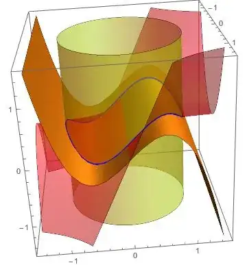

We can obtain a surfaces $S_3$ containing the intersection curve, which is more handy
$$ S_3(x,y,z) = (S_1\circ S_2)(x,y,x) = (1-y^2) y -z=0 $$
In gold color we have $S_3(x,y,z)$
Now the solutions for
$$ \frac{d}{dy}((1-y^2) y) = 0\\ $$
are contained into the set of stationary points in $S_1(x,y,z)\cap S_2(x,y,z)$

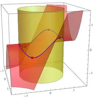

The stationary points for the problem are
$$ \left[ \begin{array}{ccc} x & y & z \\ -\sqrt{\frac{2}{3}} & -\frac{1}{\sqrt{3}} & -\frac{2}{3 \sqrt{3}} \\ -\sqrt{\frac{2}{3}} & \frac{1}{\sqrt{3}} & \frac{2}{3 \sqrt{3}} \\ \sqrt{\frac{2}{3}} & -\frac{1}{\sqrt{3}} & -\frac{2}{3 \sqrt{3}} \\ \sqrt{\frac{2}{3}} & \frac{1}{\sqrt{3}} & \frac{2}{3 \sqrt{3}} \\ \end{array} \right] $$
Those points are shown in red over the intersection

  • Your analysis seems to treat all three axes as input space for higher dimensional functions $S_n$, whereas the functions in the initial problem each have only two inputs, and the $z$-axis is output. Does this affect anything? – user10478 Dec 20 '18 at 18:24
  • +1. Nice graphs and analysis. What software did you use to draw the graphs? Is there an online graphic calculator? Can desmos handle this? – farruhota Dec 20 '18 at 18:35
  • @user10478 I made the $3D$ representation to show the intersection of the two surfaces. The results include the two dimensional case. The $z$ axis gives the objective function values, etc. – Cesareo Dec 20 '18 at 20:27

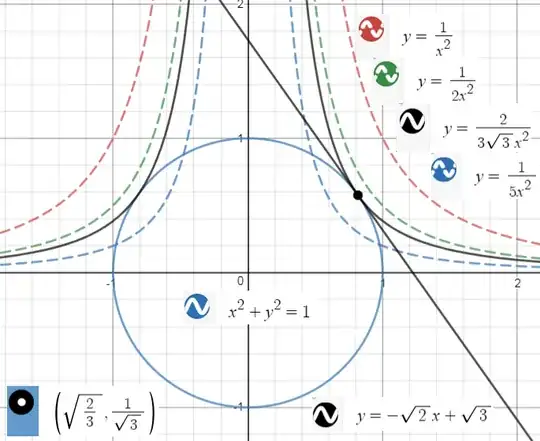

Method 1. Use the contour curves $y=\frac f{x^2}$, where $f$ is considered constant. Draw the contour curves (for various positive values of $f$ for maximum) and the constraint on the same graph:
Note that, if you look at the first quadrant, the red contour line implies the value of $f_1=1$ (it does not intersect the circle, so does not satisfy the constaint), the green $f_2=\frac12$ (again, it does not satisfy the constaint), the solid black $f_3=\frac2{3\sqrt{3}}$ (it touches the circle and the touching point is the optimal), the blue $f_4=\frac15$ (it crosses the circle at two points and at those two points the constaint is satisfied, however, those two points are not optimal, because the value of $f_4=\frac15$ is less than $f_3$.
How to find the touching point? You need to make sure the contour curve $y=\frac f{x^2}$ and the circle $x^2+y^2=1$ have a common tangent line. Let $(x_0,y_0)$ be the tangent point. Then: $$\begin{cases}y=\frac f{x_0^2}-\frac{x_0}{\sqrt{1-x_0^2}}(x-x_0) \\ y=\frac f{x_0^2}-\frac{2f}{x_0^3}(x-x_0) \end{cases} \Rightarrow x_0=\sqrt{\frac 23}; f_{\text{max}}=\frac{2}{3\sqrt{3}}.$$
Method 2. Just for reference. Use AM-GM: $$x^2+y^2=1 \Rightarrow 1=\frac{x^2}{2}+\frac{x^2}{2}+y^2\ge 3\sqrt[3]{\frac14x^4y^2} \Rightarrow yx^2\le \frac{2}{\sqrt{27}}=\frac{2\sqrt{3}}{9},$$ equality occurs for $\left|\frac x{\sqrt{2}}\right|=y=\frac1{\sqrt{3}}$. Hence: $f(\pm\sqrt{\frac{2}{3}}, \frac{1}{\sqrt{3}})=\frac{2\sqrt{3}}{9}.$
