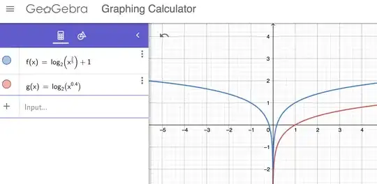

I don't know if this is the right place to ask a question about middle school-level math, but I'll give it a shot. I don't have the background to fully understand related questions (like How to calculate a decimal power of a number), but my son, who's currently taking Algebra I, has been asking me how logs affect other functions. I don't have much of an answer, but in exploring, we found something kind of weird. The graphing calculator at GeoGebra plots $\log_2(x^{2/5})$ with curves on both sides of the y axis but $\log_2(x^{0.4})$ only shows up on the right side. (We used $\log_2$ instead of $\ln$ because it was easier for us to think about.)
We get that fractional exponents work like this:
$$ x^{\frac{a}{b}} = \sqrt[b]{x^a} $$
And exponents with even numerators have positive y values for positive and negative values of x, so log of them is defined.
My guess about why $\log_2(x^{0.4})$ is only on the right side is that if you were going to vary the exponent continuously, the evenness of the numerator would oscillate extremely. And expressing the exponent as a decimal implies that kind of continuous variation rather than clearly distinguishing the numerator and denominator.
Is that kind of the right explanation (for me and a 7th grader, that is)?
Thanks in advance to anyone who's willing to talk about this at our level.

As you know, 0.4 and 2/5 are the same, so the plots should (apart from the vertical shift by 1) be identical. The cause of the discrepancy is due to the way the calculator was programmed, so without looking under the hood I can't say for sure, but I have a guess:
When you type $x^{2/5}$, GeoGebra probably recognizes the 2 as an integer in the fraction, whereas when you put in $x^{0.4}$ it's probably treated as a floating-point number (a different way for a computer to store numerical values using something like scientific notation), so in the latter case, GeoGebra doesn't "realize" that the $x^{0.4}$ will always be positive.
Does that help? P.S. You were on the right track with the idea about evenness; a full answer as to what happens as the exponent varies continuously would require complex numbers.
