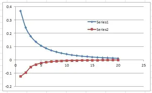

Here are some graphs made using the first technique. The red curve shows function values, and the blue curve shows (estimated) derivative values:
graphs

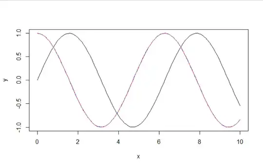

Here is a simple way to implement the spline fitting and derivative taking in R:
x       <- 0:100/10 # x = vector incrementing by 0.1
y       <- sin(x)
f       <- splinefun(x,y)
d_est   <- f(x, deriv = 1)
## since we know d/dx sin(x) = cos(x), check:
## but note that it is not exactly equal b/c of different approaches
d_exact <- cos(x)
plot (x, y, type = 'l') lines(x, d_est, col = 'blue') lines(x, d_exact, col = 'red', lty = 2) # lty makes a dashed line
This generates a figure showing y in black, d(y) estimated with spline in blue and d(y) using the definition d/dx sin(x) = cos(x) in dashed red.
