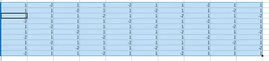

I inverted the matrix of coefficients for the $10 \times 10$ case in a spreadsheet. If we call the entries of the matrix $a_{ij}$ we get $$a_{ij}=\begin {cases} -\frac 23&j \gt i, j-i \equiv 1 \pmod 3 \\ -\frac 23 & i \gt j,i=j \equiv 0 \pmod 3 \\\frac 13 & \text {otherwise} \end {cases}$$ You can multiply the column matrix of the $c_i$ by this to get the $x_i$. I am sure the pattern will continue for all matrices of size $1 \bmod 3$. You can verify the inverse by multiplying it by your coefficient matrix. It will take some keeping track of indices, but it should work. An image of three times the inverse in the $10 \times 10$ case is below. enter image description here
This gives $$x_1=\frac 13 \sum_{i=1}^{100} c_i-\sum_{j=1}^{33}c_{3j-1}$$ and all the others are cyclic shifts of this.
