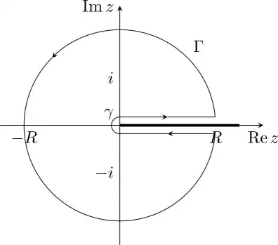

We have $$ \int_0^1 \frac{\ln(1+x)}{x^2+1}dx= \left[\begin{array}{l} t=\frac{1}{x} \\ dt=-\frac{1}{x^2}dx \end{array}\right]=\int_1^\infty \frac{\ln(t+1)-\ln{t}}{1+t^2}dt= \left[\begin{array}{l} u=t-1 \\ du=dt \end{array}\right] = \int_0^\infty \frac{\ln(u+2)-\ln(u+1)}{1+(u+1)^2}du. $$
I am quite confident that this integral can be handled with a keyhole contour in much a similar way as this integral. If you want me to do more details, just comment, and I will update when I have the time.
EDIT: Continued the argument. Please notify me about misprints or other errors. I will show how to compute $$\int_0^\infty \frac{\ln(x+2)}{1+(x+1)^2}dx$$ (the other one is solved analogously).
Keyhole contour
We now consider the integral $$\int_C \frac{\log^2(z+2)}{1+(z+1)^2}dz,$$ where $C$ is the keyhole contour above. Note the choice of logarithm! It is imperative that we take $0<\arg{z}<2\pi$ for the logarithms (or $2\pi n<\arg{z}<2\pi (n+1)$ for some $n\in\mathbb{Z}$).
The integrand has poles at $z=-1\pm i$, and by Cauchy's integral formula, we get $$ \int_C \frac{\log^2(z+2)}{1+(z+1)^2}dz= \int_C \frac{\log^2(z+2)}{(z+1+i)(z+1-i)}dz= 2\pi i\left(\frac{\log^2(1-i)}{-2i}+ \frac{\log^2(1+i)}{2i}\right)= \pi(\log^2(1+i)-\log^2(1-i))= \pi\left(\left(\ln\sqrt{2}+\frac{i\pi}{4}\right)^2-\left(\ln\sqrt{2}+\frac{7i\pi}{4}\right)^2\right)= \frac{6\pi^3-3i\pi^2\ln{2}}{2} .$$
The integral along $\gamma$ goes to zero as the inner radius goes to zero, and the integral along $\Gamma$ goes to zeros as $R\rightarrow\infty$ (this can be shown using the ML-inequality).
Therefore, in the limit we only get contributions from the straight parts, so $$ \int_0^R\frac{\log^2(x+i\varepsilon+1)}{(1+x+i\varepsilon)^2+1}dx+ \int_R^0\frac{\log^2(x-i\varepsilon+1)}{(1+x-i\varepsilon)^2+1}dx\rightarrow \frac{6\pi^3-3i\pi^2\ln{2}}{2}. $$ But we also have $$ \int_0^R\frac{\log^2(x+i\varepsilon+2)}{(1+x+i\varepsilon)^2+1}dx+ \int_R^0\frac{\log^2(x-i\varepsilon+2)}{(1+x-i\varepsilon)^2+1}dx\rightarrow \int_0^\infty\frac{\ln^2(x+2)-\left(\ln(x+2)+2i\pi\right)^2}{(1+x)^2+1}dx= \int_0^\infty\frac{4\pi^2-4i\pi\ln(x+2)}{(1+x)^2+1}dx, $$ so $$\int_0^\infty\frac{4\pi^2-4i\pi\ln(x+2)}{(1+x)^2+1}dx=\frac{6\pi^3-3i\pi^2\ln{2}}{2}.$$ By considering the imaginary part, we get that $$\int_0^\infty \frac{\ln(x+2)}{(x+1)^2+1}dx=\frac{3\pi\ln{2}}{8}.$$
It is possible to compute $$\int_0^\infty \frac{\ln(x+1)}{(x+1)^2+1}dx$$ analogously, and then take the difference in order to find the value of the original integral.

  • I'd appreciate if you might add more details. Thanks. (+1) – user 1591719 Feb 14 '13 at 09:33
  • I will continue the argument when time allows, then. – Mårten W Feb 14 '13 at 12:50
  • Sure, no problem. There is no hurry for me. – user 1591719 Feb 14 '13 at 12:52
  • I would really be interested to see if this works. I have a contour integral, but only after a pretty difficult substitution. – robjohn Feb 14 '13 at 17:46
  • @MårtenW: thank you for your work! It'll be a good lesson to me in terms of complex analysis. – user 1591719 Feb 15 '13 at 17:52
  • @MårtenW I like the figure, which program did you use to draw it? – HorizonsMaths Feb 18 '13 at 00:27
  • @Mercy: This particular one was done in $\LaTeX$ and tikzpicture, and quite long ago. Nowadays I usually find Asymptote (http://asymptote.sourceforge.net/) easier though. – Mårten W Feb 18 '13 at 08:28
  • @MårtenW Something is wrong here. The integrand isn't holomorphic (or even defined) at $z = -2$ ($\log(0)$) and this point is inside the contour. I don't think the residue theorem applies. – PeterM Feb 25 '13 at 13:34
  • @PeterM: Yes there are clearly some major problems. The entire branch cut (the ray starting at $z=-2$ and going rightward along the real axis) should be outside the contour, and this changes the limits in the integrals along the straight parts. I shall see if I can remedy this, otherwise I feel obliged to remove the answer. – Mårten W Feb 26 '13 at 22:12
