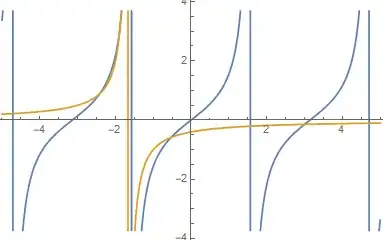

$(a⋅x+b)⋅\tan(x)+c=0$, when $\cos(x)\neq 0$ $$\tan(x)=\frac{-c}{a⋅x+b}$$ It sort of looking like this, when, say, $a=2, b=3, c=5$:a=2, b=3, c=5
