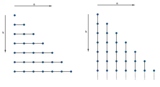

One approach is to note that for $S_k:=\sum_{n\geq k}\frac{1}{2^n}$ you have $S_0=2$ and $S_{k+1}=\frac{1}{2}S_k$. Now rearranging terms in the summation yields $$\sum_{n\geq1}\frac{n}{2^n} =\sum_{n\geq1}\sum_{k=1}^n\frac{1}{2^n} =\sum_{k\geq1}\sum_{n\geq k}\frac{1}{2^k},$$ corresponding to the following picture: enter image description here The inner sums equal the $S_k$, so we can simplify this to $$\sum_{k\geq1}S_k =\sum_{k\geq1}\frac{1}{2^k}S_0 =S_0\sum_{k\geq1}\frac{1}{2^k}=S_0S_1=2.$$
Servaes
  • 67,306
  • 82
  • 171
    Well not me! In fact, I can use your approach to get a direct solution to the $n \ge 2$ summation. I wind up with $S_2 \times S_0 = 1$. So don't feel bad - accepting and upvoting your answer! – CopyPasteIt Dec 12 '18 at 15:14
    Glad to hear that! And indeed the argument can be generalized (or repeated?) to evaluate $\sum_{n\geq 0}\frac{f(n)}{2^n}$ for any polynomial $f$. – Servaes Dec 12 '18 at 15:25
