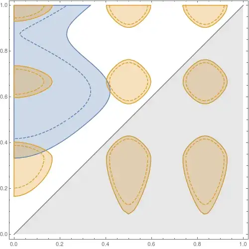

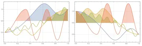

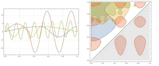

Proposition 1: Let $T:=\{(a,b)\in[0,1]^2:a\leq b\}$ and let $f:T\to\mathbb{R}^2$ be continuous. Assume that $f(0,r)+f(r,1)=(1,1)$ holds for all $r\in[0,1]$ and that $f$ is $(0,0)$ on the edge $E:=\{(a,b)\in T:a=b\}$. Then there exists $v\in T$ such that $f(v)=(\frac12,\frac12)$.
In can easily be seen that your statement follows from Proposition 1 by considering $$F(a,b)=\left(\int_a^bf(x)\mbox{d}x,\int_a^bg(x)\mbox{d}x\right).$$ I think it is unlikely that you can prove your statement with a proof that can not be manipulated to also prove Proposition 1. However, Proposition 1 can be shown equivalent to a version of the Borsuk Ulam theorem, only using arguments from real analysis. Since I don't think anyone ever came up with a proof of the Borsuk Ulam theorem only using arguments from real analysis, I think it is unlikely that you can prove your statement only using arguments from real analysis. The version of the Borsuk Ulam theorem I am talking about is the following.
