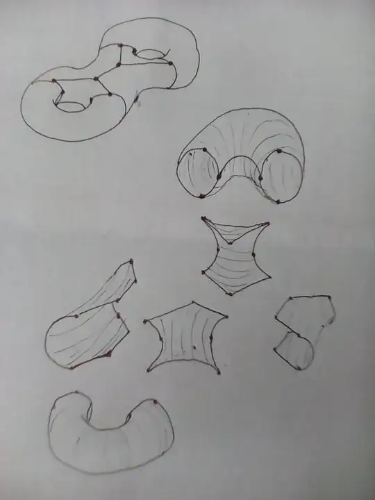

enter image description hereIf you cover the double torus with only hexagons and octagons such that edges and vertices form a 3-regular graph, then you need exactly 6 octagons.
$$ f_6+f_8+(6f_6+8f_8)/3=(6f_6+8f_8)/2 + \chi $$ Since $\chi=-2$, we have $f_8=6$. From Euler's formula there is no restriction for the number of hexagons, but maybe there are geometric restrictions. The picture shows a covering with 6 octagons and no hexagon.
san
  • 13,742
  • +1 very illustrative. Thanks. Concerning the octagons at the edge of the double torus (at the outside of the handles) it looks like that they split in two non connected squares, although the "face" is bounded by 8 vertices. Interesting... how does that relate to the linked stuff in Josh's comment? – draks ... Dec 31 '18 at 12:48
  • I don't see the squares. The regular maps in the link in Josh comment require the faces to be embedded,i.e. no self-intersection, so my covering is not a regular map. – san Dec 31 '18 at 14:16
  • Squares are the cycles of length 4 at the cutted handles. Thanks pointing out the difference to Josh... – draks ... Jan 01 '19 at 13:13
  • Maybe you mean the 3 cycles? – san Jan 02 '19 at 00:43
  • Ah I thought that squares. But then I don't get how to form the fifth and sixth octagon... – draks ... Jan 02 '19 at 09:32
  • The most left and the most right octagons have half circles that match the half circles of the 3 cycles – san Jan 03 '19 at 02:10
