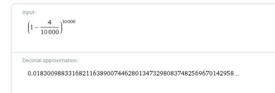

As for your method of checking, I would generate a table (maybe in matlab or Mathematica) try for $a=2$, so we should get $e^{-4}\approx 0.0183$. $$(1-4)^1=-3$$ $$\vdots$$ $$(1-\frac{4}{36})^{36} \approx 0.01440$$ $$(1-\frac{4}{49})^{49} \approx 0.01541$$ For larger values the computer will start rounding and behaving weirdly, Wolfram alpa gives amazing fractions, but only up to some point. It will also be like "ehhh how about no" after some point and start rounding and truncating. https://www.wolframalpha.com/input/?i=(1-%5Cfrac%7B4%7D%7B49%7D)%5E%7B49%7D
Actually, wolfram alpha is really amazing, it can easily compute: $$ (1- \frac{4}{1000})^{1000}=0.0181693095355$$ with impeccable accuracy.
https://www.wolframalpha.com/input/?i=(1-%5Cfrac%7B4%7D%7B1000%7D)%5E%7B1000%7D
At some point it WILL approximate: enter image description here
