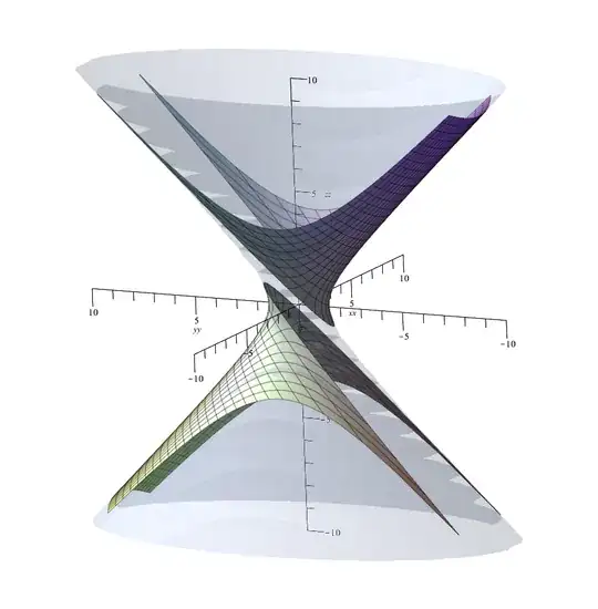

Note that for such a parametrization one is allowed to take all but the $Y = 0$. Finally, it could be helpful to take a look at the visual result of our parametrization. Here I provided the picture for $b = 1/2$. The blue hologram of hyperboloid is created using its implicit function while the "more accurate" portions of it are produced using our rational parametrization for $X \in [-2,2]$ and $Y \in [-18, -0.8] \cup [0.8, 18]$. enter image description here
