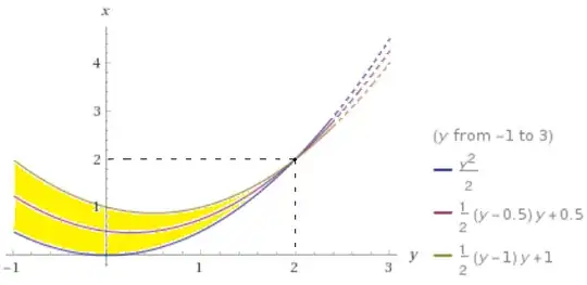

Therefore, the characteristics are the curves $x = t + y(y-t)/2$ for $0<t<1$, along which $f$ is given by $$ f(x,y) = y - \frac{x-y^2/2}{2-y} \, . $$ One can note that this expression is not defined at $y=2$, where the denominator vanishes. The solution is only valid over the domain in yellow $$ (x,y) \in \lbrace (t + y(y-t)/2, y), 0<t<1, y<2\rbrace $$
characteristics
Indeed, we start following characteristic curves at some point $(t,t)$ with $0<t<1$. On the one hand, we can decrease $y$ without restriction. But on the other hand, we cannot increase $y$ further than $y=2^-$. At the point $(x,y) = (2,2)$, all characteristic curves coming from $\lbrace(t,t), 0<t<1\rbrace$ intersect. The classical solution collapses (similar case to this one).
The reason why the domain of validity is restricted to $y<2$ relates to the following Riccati ODE problem for $q = \partial_x f$: $$ \tfrac{\text d q}{\text ds} = -q^2, \quad\text{letting}\quad q(0) = (t-2)^{-1}, \quad\text{we know}\quad q = (t+s-2)^{-1} , $$ which is derived from the initial PDE problem by partial differentiation with respect to $x$. The solution rewritten as $q(x,y) = \frac{1}{y-2}$ blows up at $y=2$ and cannot be used for larger times (even if the solution function is defined for $y>2$). See also the derivation by Lax, leading to Eq. (6.10) p. 36 of (1).

  • Why is the solution only valid on the domain in yellow when $f(x,y)$ is defined for all $x$, $y \neq 2$ ? It seems to me that the validity of the solution still holds outside although we might lose unicity since the associated system of ODE does not have initial conditions. – h3h325 Dec 05 '18 at 15:45
  • I understand why the solution is not valid for $y =2$, I also see why the idea behind the method should fail if the characteristic curves intersect. But as I see it for $y>2$ the function $f(x,y)$ satisfies the pde and also the initial condition, so why can we not take it as a solution? Thanks a lot for the answer by the way. – h3h325 Dec 05 '18 at 16:12
  • I see! So the conclusion is that the solution still holds but we cannot guarantee uniqueness, right? – h3h325 Dec 05 '18 at 16:22
  • Sorry if im beeing too picky but I still don't get your point. The system of ODEs does have a solution by Picard-Lindelöf (even if it is not unique), since 1, 1 and $f$ are lipschitz, for any $[S, \infty)$, for some $S$ corresponding to $y >2$, so why are we losing existence? Also $f(x,y)$ satisfies the PDE everywhere where it is defined, and also the initial conditions. So how is $f$ not a solution? Could you maybe refer me somewhere were this is explained? – h3h325 Dec 05 '18 at 16:43
    @h3h325 I'm troubled by your statement about Picard Lindelof, please note that it is a local existence and uniqueness theorem – operatorerror Dec 07 '18 at 18:24
  • @h3h325 i have edited the answer for clarity about the domain of validity. Please delete old comments. – EditPiAf Dec 08 '18 at 08:49
