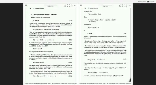

I have the linear system $y' = A(t)y$ where $A(t)$ is a continuous n-by-n matrix of period $\omega$. I want to show that if $-1$ is a multiplier of this system, then there is a solution of at least period $2\omega$. I am stuck on figuring out how to begin.
Here is the relevant material: enter image description here
So Step 1: What happens when $-1$ is a multiplier of the system? This means $-1$ is an eigenvalue of the nonsingular matrix $\exp(\omega R)$ where $R$ is a matrix. Here I do not know how to proceed.
    So, $-1$ is an eigenvalue of $\exp{(\omega R)}$. That means that there is also an eigenvector $v$ corresponding to this eigenvalue. Start with $v$ as an initial condition $y(0)$. What $y(\omega)$ equals? What $y(2\omega)$ equals? – Evgeny Dec 03 '18 at 12:00

The situation is that you know from the fundamental matrix solution $\Phi$ to your ODE system, $$ Φ'(t)=A(t)Φ(t),~~Φ(0)=I $$ that $Φ(ω)$ has an eigenvalue $-1$. Additionally you know from the periodicity of $A$ that $Φ(ω+t)=Φ(t)Φ(ω)$.
Let $v$ be an eigenvector, then $y(t)=Φ(t)v$ is a solution with initial value $y(0)=v$ and $$ y(ω)=Φ(ω)v=-v,~~y(2ω)=Φ(ω)^2v=v. $$ which means that the trajectory of that solution returns to the initial point.

  • Why do we have $\Phi(\omega)^2$ instead of $\Phi(2\omega)$? I know we have $\Phi(2\omega + t) = \Phi(t)\Phi(2\omega)$, but don't see how this translates to having $\Phi(2\omega) = \Phi(\omega)^2$ – KZ-Spectra Dec 03 '18 at 16:06
  • You also have the same relation with $ω$ instead of $2ω$, as mentioned in the answer. From there $Φ(2ω)=Φ(ω)^2$ directly follows. That $Φ(nω)=Φ(ω)^n$ is the inspiration to look into a factorization that makes $Φ(t)=P(t)Φ(ω)^{t/ω}$ formally correct. – Lutz Lehmann Dec 03 '18 at 16:14
  • I see. My other question: The exercise wanted had the wording "...show there is a solution of at least period $2\omega$". What you showed was there is a solution of period $2\omega$. So why is there the "at least" wording? – KZ-Spectra Dec 03 '18 at 16:20
  • This argument only shows that $2ω$ is one period of the solution. There might be a minimal period that is a fraction of that. Like $y(t)=\cos(5t)$ has a period $2\pi$ with $y(0)=1$ and $y(\pi)=-1$, but the minimal period is $2\pi/5$. But as $2ω$ definitely is a period of the solution, the "at least" might have another interpretation. – Lutz Lehmann Dec 03 '18 at 16:28
  • Thank you. For my very first question I just had to write $\Phi(\omega+\omega)$ to get what we wanted. Apologies and thank you for your time! You really helped a lot! – KZ-Spectra Dec 03 '18 at 16:34
