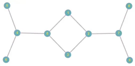

An automorphism on a structure describes a symmetry on that structure - a way in which certain elements of the structure play identical roles within the structure.
For example, a graph isomorphism is a bijection between the sets of nodes of two graphs such that $x$ and $y$ are adjacent (have an edge connecting them) if and only if $f(x)$ and $f(y)$ are adjacent. This means that the two graphs are really the same graph (they can be made to look identical if they're drawn in the right way).
Now look at this graph:
I'm sure you would understand what I meant if I said that the vertices 5, 6, 8 and 9 all "play the same role" in the graph. Vertices 0 and 2 also "play the same role". But vertices 5 and 1 play very different roles, they don't fit into the graph in identical ways (for example, 5 has one neighbor while 1 has two). This is due to the obvious symmetries which exist in this graph, corresponding to the two automorphisms of the graph given by:
  1. $f$ such that $f(5)=6, f(6)=5, f(1)=3, f(3)=1, f(8)=f(9)$, and $f(x)=x$ for all other nodes.
  2. $g$ such that $g(5)=8, g(8)=5, g(4)=7, g(7)=4, g(0)=2,g(2)=0, g(6)=9, g(9)=6$, and $g(x)=x$ for all other nodes.
The fact that 5 and 1 do not play the same role corresponds to the fact that there is no automorphism mapping 5 to 1 or vice-versa.
